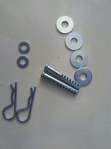

Disconnecting helps a TON for ride and traction (keeps all 4 tires weight on the ground more). For your sport, you can also do what I do and use 2.5"x7/16" Clevis pin and make your own discos for $5
Old Mar 4, 2013 | 06:34 AM
kh202's Avatar
Posts: 3,142
From: Rockwood, TN
Replaces bottom bolt and then use a strap or zip ties to hold everything out of the way when you disco. Been running this over a year.

Where did you purchase your Clevis Pin
Old Mar 4, 2013 | 01:58 PM
kh202's Avatar
Posts: 3,142
From: Rockwood, TN
Lowes like $2 each. They're in the pull out drawers in hardware.
