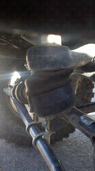

Passenger side

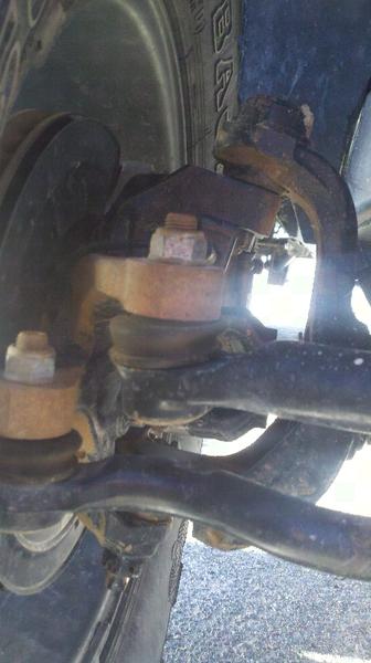

Driver side

Ok is this the track bar first off & second are the 2 pivots supposed to be slanted like that. Also I was getting a popping sound when turning my steering wheel today it sounds like its coming from the steering linkage any idea what this could be.

That's the drag link. It's supposed to be able to pivot like that. You can grab it and twist it bact to straight.
As long as there is no vertical play in the joints, they are good.

Ok so the track bar is the one from tire to tire & the drag link doesn't have any versicle play I was just making sure that wasn't wrong. Now to find the phantom pop.
The tie rod goes from tire to tire.
The track bar goes from the frame to the axle.

Im just batting 1000% today. Thank you for the help
