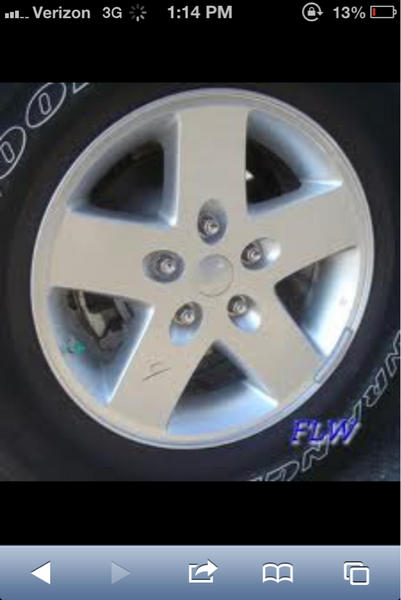

I have an 08 jeep jk x its the basic model i recently bought a set of used tires and wheels and now i have the death wobble the guy at the tire store said it could be the rims because when i put them on it was tough to get them to sit flush on the hub please help i personally think its because the tires are cupped and about bald here's a pic of the wheel i had and the ones i have now

I doubt what you're experiencing in actual "death wobble", but probably just some pretty extreme vibrations caused by the worn out tires. I know when my original tires finally reached the end, they started to vibrate pretty badly above 50 mph due to the wear pattern on them. One set of new tires later, everything is good again.
You can have the wheels and tires balanced and that might take care of it, but if you're able to tell that they're cupped in the middle already then it's probably not worth the money. You need new tires.

what year and model jeep do you have?
also what size wheel do you have? is it the 16s or 17s
i would take a bet its your tires but idk

Well my jeep come with 16" rims and 225 tires im now running 17" and 255's and my jeep is a 2 door 2008

Couple of things to check, you say had a hard time seating the wheel on the hub, make sure all 4 are completely flat against the hubs, and also that if there are any retainer clips on the lugs remove them, a lot of times those will be on autos with Steele wheels and not let an aluminum wheel sit flush against the hub, also could have a bent wheel being they are used, lastly as others have said, may be crap tires, one or may may be separated, flat spotted or just out of round.

Awesome i remember clips being on the lugs i didnt think to take them off ill try that

Ok took the clips off and got brand new 285/70/r17 mastercrafts so hopfully it will stop the wobble

FIXED !!!!
No more wobble or shimmy or nothing it rides like the day it come off the lot
