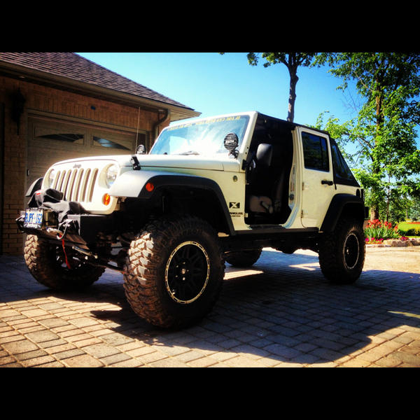

A stock jku can take 33" tires with flat fenders. With a 2.5" lift you can run 35" tires without rubbing. If you put a three inch lift on it and put 31" tires it will look like a roller skate. I would say 35" tires are what you would want with a 3" lift. Keep in mind though at the 3" lift area and beyond you start having issues with drive shafts and may need adjustable control arms to help with the flighty steering.
here is a picture of a 3.5" lift with 32" tires
http://i49.photobucket.com/albums/f2...Jeep/Lift3.jpg
here is a picture of a 3.5" lift with 35" tires
https://www.jk-forum.com/forums/atta...p;d=1339450752
Old Jun 11, 2012 | 08:57 PM
Mr. Smiley's Avatar
Posts: 460
From: Holly Springs, NC
You can run 33's with out any lift and 35's with flats and no lift. Also know, that on the 2012's you are going to have to buy an exhast spacer so your front drive shaft doesnt come in contact with your exhaust.
