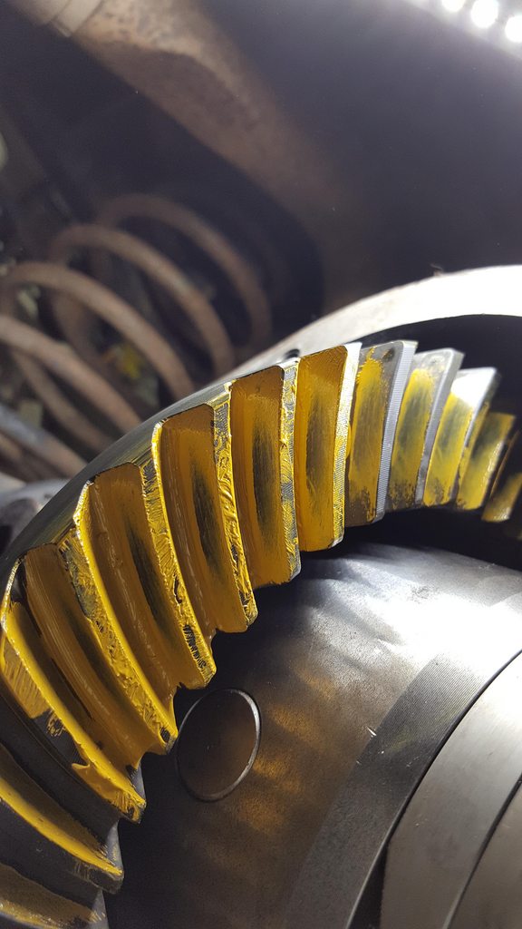

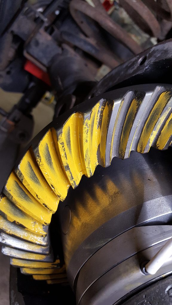

I'm posting this here because I have never seen this kind of contact pattern before. The drive side looks good to me.... but I wanted to validate that here. The issue is the coast side. It seems fairly well centered from the face to the flank, though the contact is out toward the heel of the ring gear. Normally, you'd fix that by increasing backlash, but I've tried .005 and .008 backlash and it doesn't make any noticeable difference on this.
I've read in a PDF from Dana that you shouldn't worry too much about this so long as your face-flank is centered and backlash measures out correctly, and I've read elsewhere that when checking brand-new gears, the drive side is the most important side. So my consensus here is that I'm good based on the backlash I have now, and based on the pattern I'm seeing on the ring gear. Would you agree?

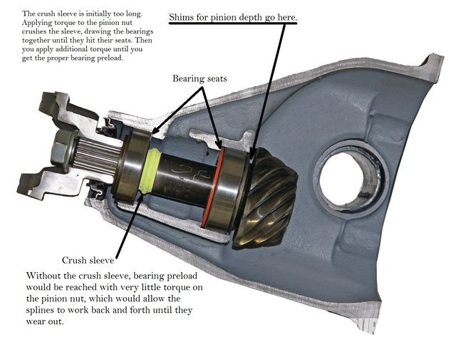

One add-on question: All the documentation I've been able to find talks about using shims to set the pinion pre-load. This jeep has a crush sleeve for the pinion and I haven't been able to locate a write-up that discusses setting the pinion preload when using the crush sleeve. When I took apart this Jeep, there was just one shim that sits between the yoke and the outer pinion bearing, and below that bearing there was a crush sleeve. I'm guessing the shim I found in there was not really a shim but a thrust sleeve? From the random forum posts I've found when searching, I think I understand that when using a crush sleeve, you don't use shims to set that pinion pre-load - instead you torque the pinion lock nut down, anywhere from 150-250 ft/lbs until the desired pre-load is reached (as tested by an inch/pound gauge, which I do have). Can anyone confirm or correct this please?

Ya regarding the pinion shim and the crush sleeve... yes, there should be a shim that goes between the pinion and the pinion inner bearing. That's how you set pinion depth. The crush sleeve is used as you describe, for bearing preload. But they are two different things and you need both. If you left out the pinion shim, that might be why you aren't getting the correct gear pattern, but it's been 2+ years since I did my gears and my memory is fuzzy. The Pirate writeup is a good one. There's also this one:

For those who may not have a good mental picture of the crush sleeve and its function:
Some pinions use shims for bearing preload rather than a crush sleeve.
With shims, you would assemble and torque the pinion nut to check preload. If not correct, you disassemble to adjust the shims, then reassemble and torque the nut. Repeat until it's correct.
With the crush sleeve, you simply apply torque until the preload is correct.

Correct. Don't worry too much about Pinion nut torque it can go higher. Just tighten until you get the rotational inch pound value. You may need a pipe on the end of your ratchet to crush it.

I followed the write-ups I came across which suggest removing the old bearings and honing out the inside mating surface of them so they can be re-installed and removed by hand multiple times. Had to buy a couple extra new bearings for this since I was unable to save all the originals when pulling them the first time. One thing mentioned in the write-ups that I didn't like was everyone said, "After you've set the backlash and pinion depth with your setup bearings, install your new bearings and re-check.... *hopefully* everything will still be the same." Yeah, hopefully, but it wasn't. The backlash stayed the same but the pinion depth changed which changed the contact pattern toward the top of the tooth. I see no reason as to how or why this happened and the unfortunate part about it is that you then have to pull the pinion again, pull the bearings back out (probably ruining them in the process unless you have the $300 clam-shell bearing remover tool which may or may not work to save the bearings), and start over again. It is almost like you need to buy a few sets of bearings, knowing you'll scrap a bunch of them in the process which just doesn't make sense to me.

I had the exact same issue. I used setup bearings just as you described and how the threads had recommended. But when I was happy with the contact pattern and reassembled using the "real" bearing, my pattern was way off. Went through a couple bearings because of that. Frustrating for sure and I don't know why I had that issue. In the end, I was "happy enough" with the pattern despite it not being the exact same as when I had done the initial setup with the setup bearings. I can't explain the change. But you aren't alone.

I believe the reason for the change is that the thickness of an assembled bearing & race varies due to manufacturing tolerances. Measure the thickness of both the setup and final use bearing/race, then use the difference to add/subtract from the shimpack to make the final check more precise.
Somewhere I've got a set of "dummy" bearings I made on a lathe ~30 years ago, just a bushing with the same dimensions as bearing + race with a slip fit to adjust shims. The slight difference between actual bearing/race and dummy bearing thickness was added/subtracted from the final shimpack. So if anyone has access to a lathe, this is an option.
