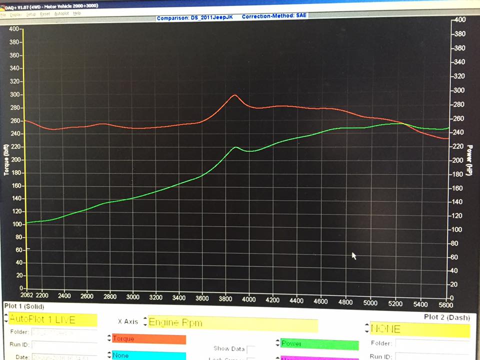

Well I been dealing with RIPP Tuning and DIABLO Tuning since October ( A whole new form of hell!) and finally had a custom tune done by EVANS Tuning, and wow The Jeep Drives Like a Grape Ape! I opted for the long tube headers and high altitude kit from RIPP and on 92 octane at 10 psi produced 283 tq / 257 whp. Spike in graph was dyno adjusting load mid pull since car was auto transClick image for larger version

ID:	669767 Finally I can drive my Jeep.

Great #'s and with an Auto trans! Odd you were having issues, I installed the kit myself and used the Diablo Tuning straight out of the box (after updating it online of course) and everything has ran great. I'm running the Intune RM1000 and the Hi Alt pulley on 91 octane. I have the Ripp long tube headers but they are not installed, I'll likely sell them because they will not pass emissions here in Cali.
