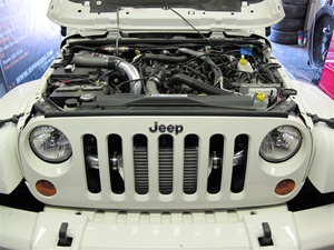

Older GEN1 kits use a Water Methanol kit to cool the charge temps down - your in Cali and Preston De-Icer is not sold there ... so that potentially could be the problem... You should get the front mounted Intercooler kit at minimum and add it to the GEN1 system... This will allow you to keep the Black Box and remove the Meth kit and deal with the heat. It will also help the CC yaw and some TRD effects the GEN1 had. Other than that you should be good...
Also - we have a really cool BOV silencer for the GEN1 - makes it really livable...
