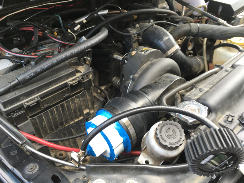

Thanks for the replies! I did make a homemade boost leak tester the other day with PVC pipe, atv gasket and a tire valve.
I ran my air compressor at around 12 psi, and the pressure would hold while I held down the gun. Whenever I would let go, it would quickly bleed out. However the only place I could detect leakage was the elbow joint before the compressor.
That joint is not supposed to be air tight, so I'm fairly confident I don't have a boost leak.
I have checked the inter cooler for any retained shop towels before.
I have sprayed the engine down with starter fluid before and not detected a vacuum leak either. I don't have access to a smoke machine for a more robust test.
The ECU reads a max of maybe -12 vacuum which seems low to me?

So I did check a few things.
-The BOV is holding vacuum appropriately.
-The engine vacuum at idle is around -22-24 psi or so. I think this is normal, so I would assume no vacuum leaks
-I made a homemade boost leak tester with PVC pipe and I do not think there is a boost leak.
-I have checked all the plumbing and didn't find any retained shop towels or debris.
I'm really not sure.
