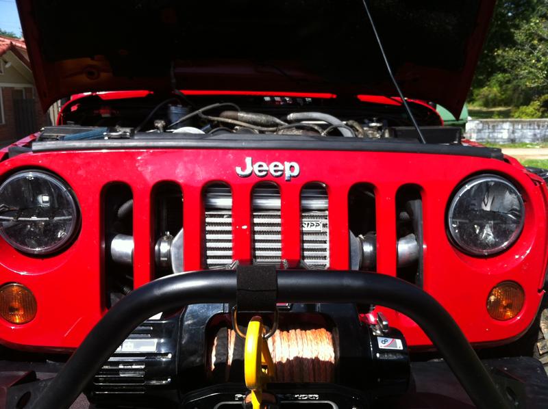

i ran a psc steer assist with supercharger. I used that same thread you posted for a guide on the install. i had to do some grinding to the front of the block where the ps pump mounts to give clearance for the pulley, i did use the washer he suggest to help align things. I also had the same issue with where to mount the ps cooler because i have a trans cooler behind the radiator. I cut the top mounts off the intercooler and secured it using the lower mounts through the bottom of the radiator support. i mount the ps cooler on top of the intercooler, had to grind the fins down to make it fit between the top of the radiator support and the intercooler.
Attachment 506502
Thanks for the info DJ, i think this might be the method of madness! lol

it worked for me. I forgot to add that i had to trim the tip of the hood latch for clearance. If you have any questions let me know.
