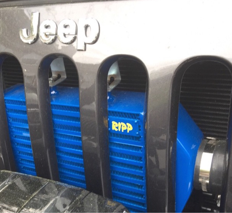

I have a Ripp on my 3.6, running 5.13's.
The torque is strong, especially when you need it in 4L off road. The gains were better than expected and I've been extremely happy with the results.
You do not need any tuner beyond the Diablo that comes with the kit.
Ripp advised against use with a snorkel, but has options if it's something you want to do.

you know painting an intercooler makes it less efficient right?
