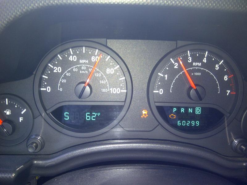

So I put the RIPP headers and supercharger on my '08 JK, and loaded the RIPP SC and Headers tune on my ride. Now when ever I get on the freeway out of my place going uphill and accelerating, and after then coming back down the hill, all of a sudden the check engine light and ESP light goes on.

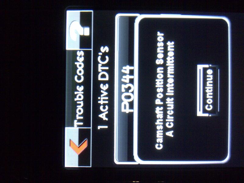

Pulled over, checked the code and get the P0344 "Camshaft Position Sensor A Circuit Intermittent" code. Reset the code and then get back on the highway and the check engine light and ESP light comes back on. I reload the tune and all seems good for a bit until I go back up and down that same hill, though it doesn't happen anywhere else.
Loaded the RIPP SC tune only, and it seems like all is good. Anyone else have this problem with the RIPP SC and header tune? Since it doesn't happen with the SC tune only, I'm wondering if it's a sensor problem, wires arcing, or connection issue, or maybe just a PCM tune issue on the header/sc tune?

Name:	San Diego-20130217-00147.jpg
ID:	424763Click image for larger version
Name:	San Diego-20130214-00144.jpg

Please take a data log with the included diablosport tuner, try to recreate the conditions under which the code appears and forward the log with a brief description to ripptuning@gmail.com. Lets see what's going on.
