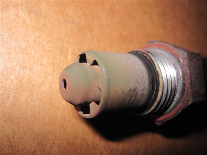

Originally Posted by frankie945
I would pull the one that is closest to the headers. When you get a chance call Ripp and see what they say. He might have a fix for the problem. The o2 sensors are kinda pricey hate to say.
i pulled the o2 sensor closest to the headers... heres a pic what do you guys think ? does it look like a bad o2 sensor ? thanks

at least it's not white. Honestly you really can't tell buy eye if there bad or not. Mainly wanted you to pull one to see if was running lean. Buy the look of that one. It should be a little blacker in color. I've pulled some that were bad and they were chaulkie white. Mainly because of the meth injection. It doesn't look bad to me. But it's hard to say for sure. I would hate for you to go out a buy new ones if that's not the problem. Call ripp and see what they say. To be safe...
hey thanks alote for your help... ill give them a call i didnt think you could tell from just looking .. but figured i would take a look just in case... thanks ill see what they say .
