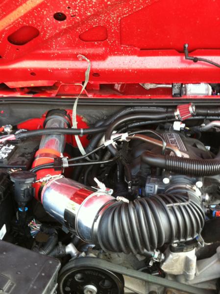

Here is a few pics of my custom snirkel and a link to my write-up... I took out the factory airbox and now run a spectre in-line airbox...
https://www.jk-forum.com/forums/show...om-Snorkel-CAI

Yea, that's the one I just found. That's pretty close to what I was wanting to do. Excellent write up and looks good. Thanks for the pics.

No doubt.... If you have any questions please ask, if you shoot I'll give you my number as well...

I ordered all my parts (list in writeup) from siliconeintakes.com

Best advise I can give is patience and check your measurements multiple times before you cut. You only get ONE shot and that's it. If the hole in cowl and firewall aren't exactly lined up it's ok, but you'd rather have it as close as possible..
