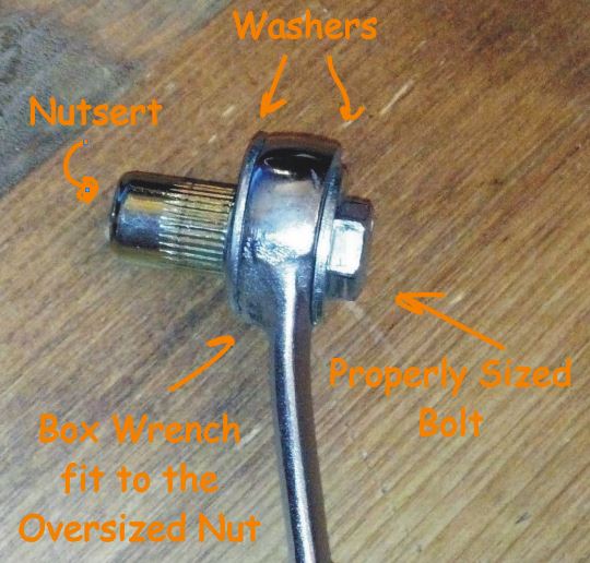

I recently installed JCR OFFROAD sliders which require 10 nutserts per side on a 4 door. They give you 21 for good measure and to be honest it took about 7 before I felt comfortable installing them. JCR gives you a "tool" which works well enough; it is a properly sized bolt and an oversized nut (the bolt threads do not engage it) and two washers that you put in/through/on the box end of a box/open wrench. The pic shows the assembled tool.
You insert the nutsert in the drilled hole then tighten the bolt with a ratchet while holding the box/open wrench steady. The bolt compresses the nutsert against the washer/oversized nut while it pulls against its washer and the wrench. The trick is knowing when to stop compressing; gotta count rotations.
If you go with the improvised tool, definitely do as hillybilly says and watch some videos, read some write-ups to get the idea clear. If you can, get a few extra and test it out on some scrap metal to get the hang of it first. Over compression is the real problem because you have to grind the nutsert off which is a delicate operation on sheet metal.
