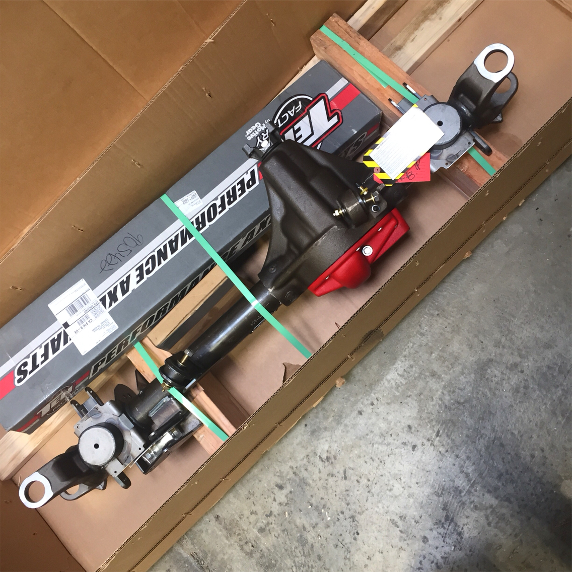

Got a call from a very confused fedex delivery guy who was bringing me new toys! This thing is amazing. Next few weeks and she should be under the rig. Ordered ARB for rear and will schedule that install soon. Need to place an order today for ball joints. Anyone got a favorite? Im on 33s and will be for awhile.
