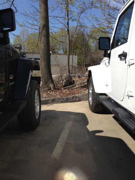

I'm running the 2.5 on my 2 door Sahara. Love it. It's right where I want to be. If I had the added weight of the 4 door, I'd probably suggest going for the 3.5.
Ill probably bump it up one day anyway, but so far it's where I want it.
I don't agree it disagree with the better than stock argument. There's a noticeable difference with bilsteins over the stock shocks. But you do notice some things are different such as steering (more like a truck) , and the resistance of the air coming at you( Boston bridges suck ) but the bumps and roads that are ,for lack of better words tilted, feels alot more comfortable.
As for mileage, I suffered about a 1 mpg loss after installing my lift.
At 35 mph she sits around 1200 Rpms and feels amazing.
Here's a pic compared to a stock front at the dealership today.

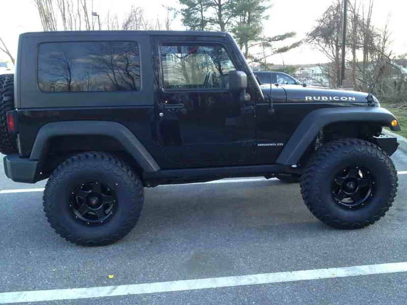

Same
2.5 2 door
3.5 4 door

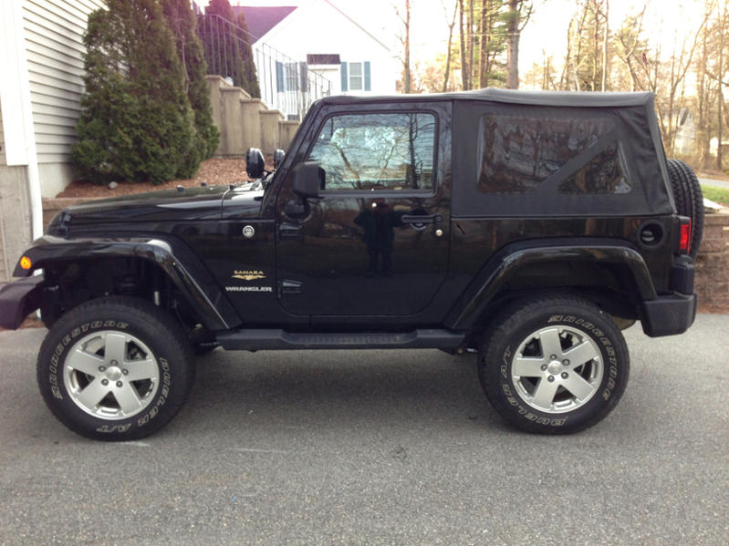

^ 2 door guys will see a ton of lift with Rk coils.
I was up over 4" when I first installed them. They settled to around 3.5"
This is with little weight. Those 3.5's are going to be tall as f***

Are those 33's or 35's? Look like 33's but can't tell for sure....
