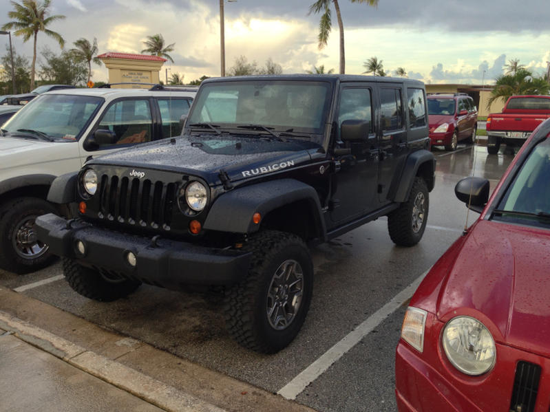

So it looks like the axel wasn't centered, off by approximately 1inch (inward rt fender). Will adjust trackbar and give updates on the progress. Thanks for the tip guys.
Anyway, here is a pic of the jeep with stock rims on RK 2.5 max travel.
I need to bring the passenger side axel come out the fender more because it appears to be about an inch inward, like cause of LCA rubbing. Do I adjust the the trackbar at at the axel mount or at the other end of the track bar? Thanks in advance.

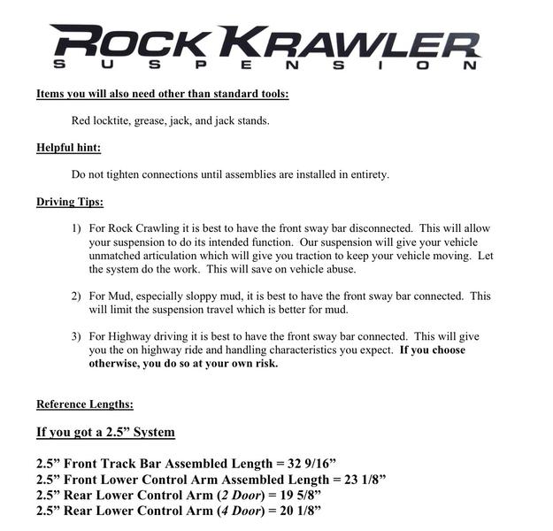

I would adjust both ends evenly (I.e have the same number of threads showing). For a 2.5" lift RK recommends the initial TB length to be 32 9/16"
