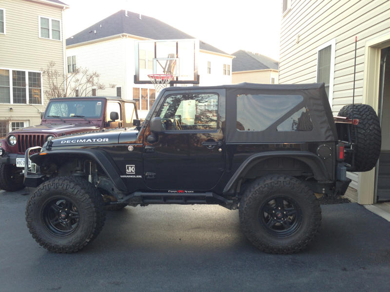

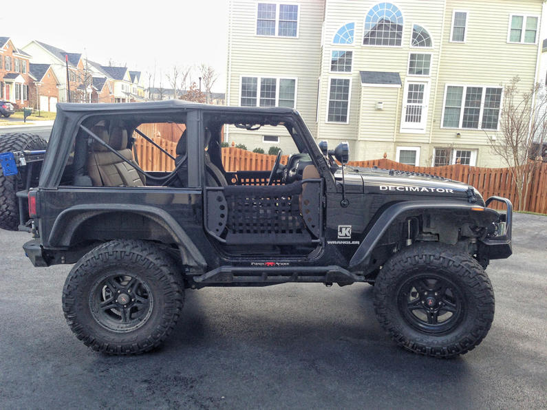

That's a great lift and I'm running the 2.5 Flex kit on 35s and bushwackers. It looks really nice and even leaves room for 37s if you wanted to upgrade. I have more pictures if you want to see them.

That looks badass! I can't wait to have mine all done. Plannin on a trip to Hot Springs Ark. soon, but still have a few things to get done. I like your ride bro! I hope to stay with 35's. I think thats all I will need. Its my DD, so I gotta watch the pocket book....lol

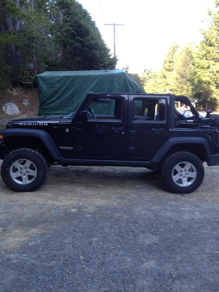

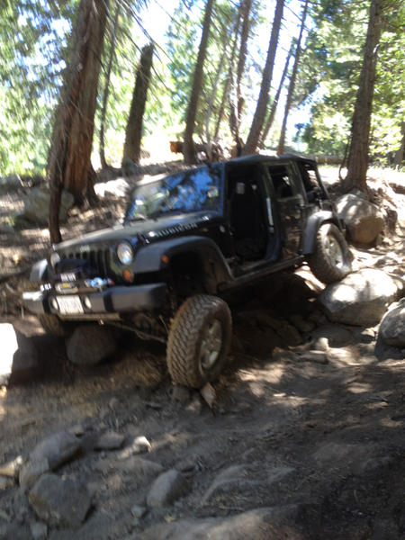

I have this kit on my four-door Rubicon. Love the kit but one of my bilstiens blew before was it was a year old. Rides nice, flexy as hell. Add the rear adjustable track bar though instead of just the bracket. I have just the bracket and my rear axle is just off centre, less than a half inch, but it bugs me.

Yep. On my 4 door I got close to 4" up front and about 3.5 in the back. It's settled a bit now though.

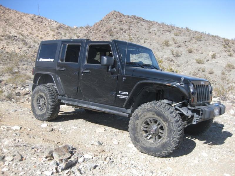

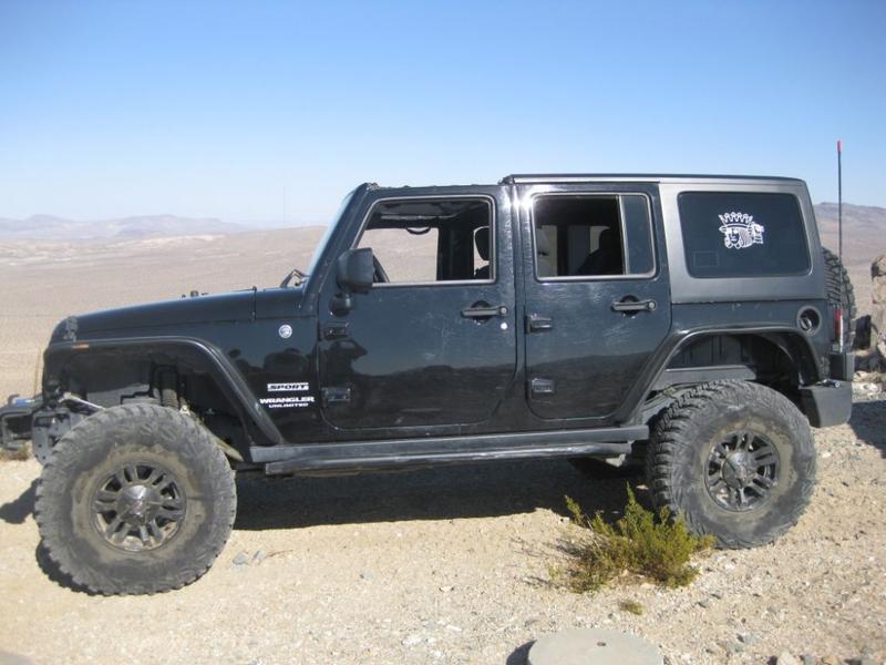

I have the RK 2.5" MT and had some issues when I moved to 35's. I had bad rubbing on the fenders and front bumper. I hacked the ends off the bumper and got flat fenders. No problems on the road, only off road when disconnected and aired down.
I also had issues with the wheels hitting the disconnects when disconnected. Had to relocate them higher and more out of the way.
I did replace my front DS when I had the lift done. I honestly don't see how you would do 37's, even with flat fenders. What bumpstops are you using for 37's? Seems like you would have to limit the flex big time!
