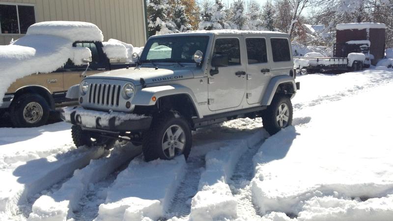

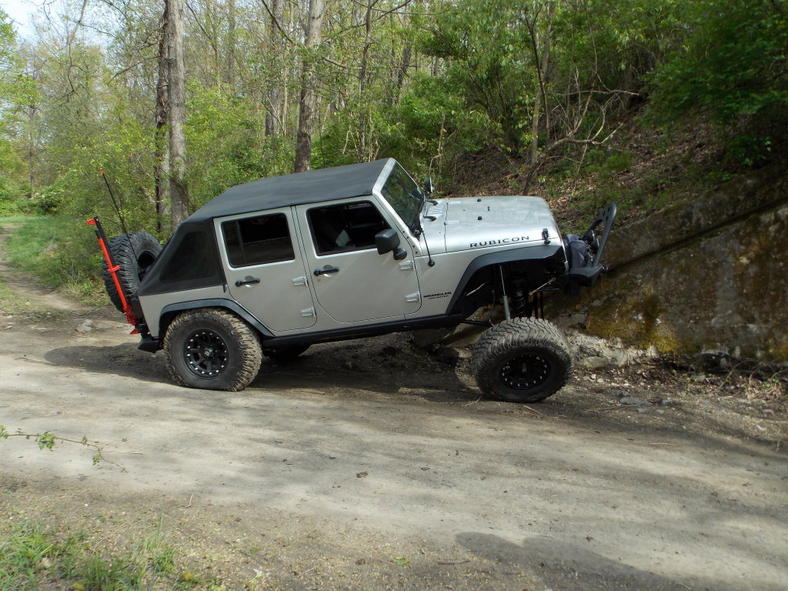

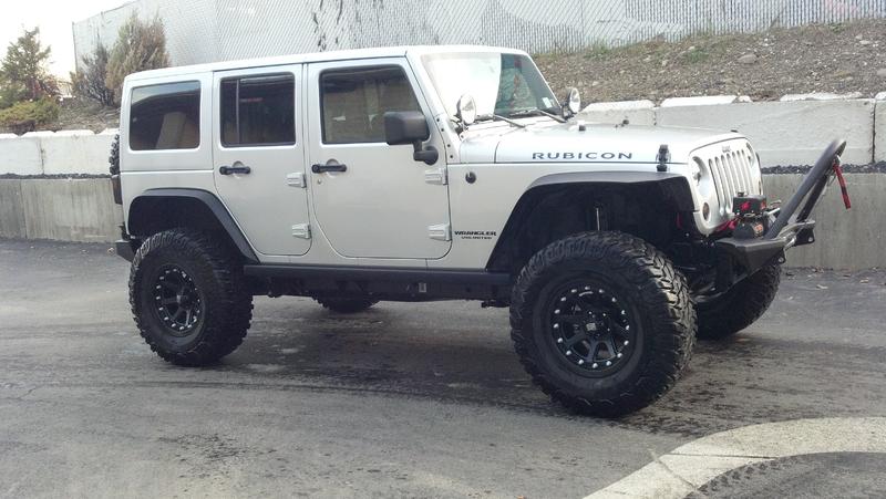

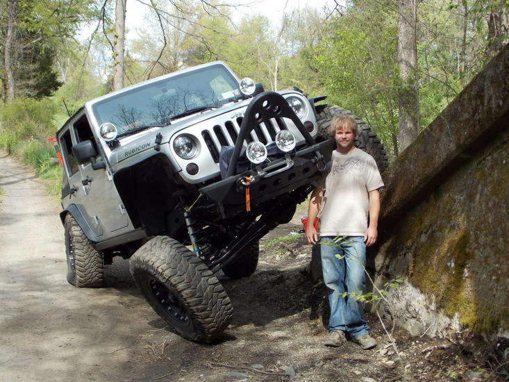

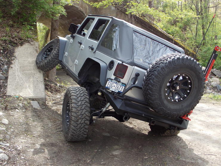

Here you go. 2012 rubicon 2.5" max travel on 37s put a tatton front drive shaft on.
Just after lift went in stock wheels and tires

I am 6 foot tall it flexs like crazy i did a few tricks to get it to flex like this though.

And 4.5" backspacing will rub LCA and frame unless you adjust your steering stops or add spacers i added spacers i like it low and wide.
