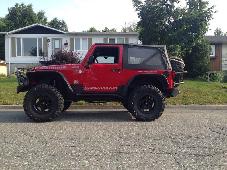

Originally Posted by Rock Krawler Suspension
Do you have any pictures of the rig from the side sitting on level ground?
RK
ho and while you're here, I'm trying to email RK since like the beggining of june to get a 2nd sticker to put on the other side of my jeep but I have no answer. :/
Originally Posted by Invest2m4
These pictures should be a sticky. It's the factory measurements. Measure the same locations and subtract the stock numbers to get your lift height.
Attachment 568010
Attachment 568011
According to these measurement, I have like 4.1" in the front and 3.8" in the rear.(that's a lot of lift for a "2.5") I took them at the same tiime as I took this picture (5 min. ago) It's not a big difference finally, Maybe I'm just crazy And I have both the rear seat and my tool bag in the trunk with these measurements.
