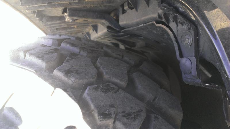

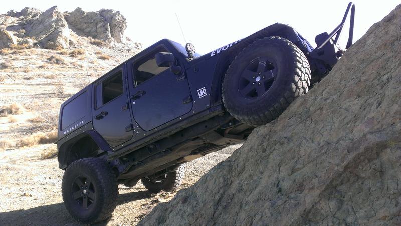

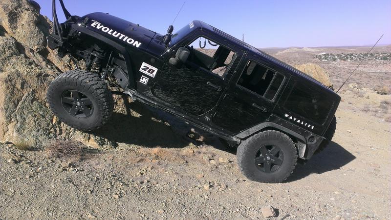

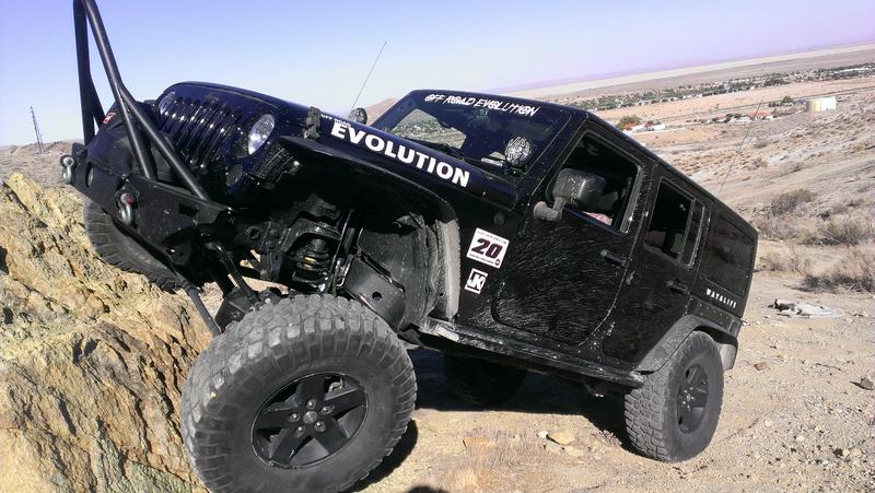

The top pic is the 2.5 with a 1.25" body lift. Bottom pic is without the body lift. I removed my body lift yesterday and flexed it out without rubbing.
