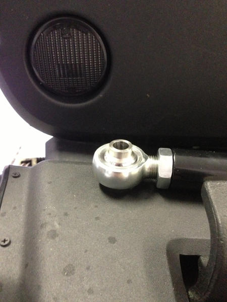

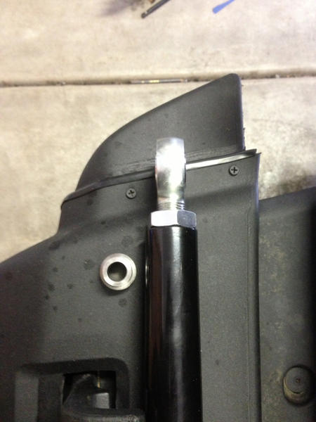

I know it goes to the axle but does the removable part go towards the front or rear of the vehicle thanks

Do you have two of those inserts? You need one on each side. I think that's what your asking.

If you are talking about the insert that goes inside the joint, then there should be two of them, one for each side of the joint.

That's what I figured I can't find the other one thanks brotha

Found it good thing I saved the boxes thanks guys it a straight mount with no rubber bushings right?

Yes, good luck with the install. Orientate the bend to the rear to clear the diff.

I had tried doing this and it put the bushing side in a bind. Fixed it by having a friend move the mount back. Well, not the mount but welded a piece just behind the existing mount so now it's back an inch or two. No problems clearing anything now.
