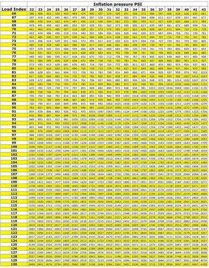

Old Mar 24, 2011 | 07:19 AM
Socal Tom's Avatar
Posts: 188
From: San Diego, CA
Originally Posted by Torrin
Check your tire pressure first and ignore the RC haters. I ran one for 2+ years and the only ride issue I had was when the shop had my tires at 60psi on 33's. If you running above 30psi on 35's, your ride will be crap.
If you are running 35s you should be running less than 30 PSI. Here is a chart I got somewhere that helps you define what you should run.Click image for larger version
Name:	tire load vs psi.jpg
The load index should be on your tire, the stock rubi tires are a load indes 121, so per the chart at 32 psi they are rated fr 2557 lbs of weight.
Goodyear duratracs in a 315x70x17 are a 127 load index, so to carry the same 2500 lbs the tire should be at 25 to 26 psi. The tires will also wear better if inflated properly like this.
Tom
