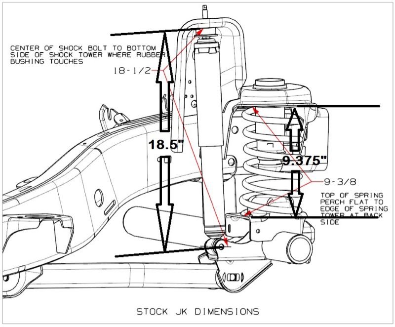

Whose coils do you have now? How much measured lift height did you receive? Are you prepared to tear it apart a second time to add a small leveling spacer if you guess wrong?
If you don't know where you're at, maybe start with the diagram showing the stock height specs and see if you can figure out where you are currently at -- before jumping into which mfg's coil might get you close to leveling the jeep with another company's rear coils.

Edit: according to the above diagram, I am at 2" of lift. With the hard top and doors on. I'll measure again in the summer. Neat!
Yeah, I have no idea how accurate those stock height diagrams might be across all JK models/years. But they have been floating around the site for a long while and are at least a place to start when comparing lift heights. And to my way of thinking at least, when trying to match coil heights from different companies, another data point is better than relying on just a stated coil height and hoping.
