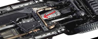

For those of you who installed only the front Rock Hard skid plate, are there any clearance issues with the exhaust? The cross-over hangs slightly lower than the transmission cross member. Can't tell by write-ups or pictures how the skid clears the pipe.

I noticed a vibration from the crossover pipe hitting the Rock Hard skid. To get rid of it I got some exhaust wrap and put a couple wraps on the crossover pipe and all is well now

I had the same vibe and took the skid off before I deployed. Bending the exhaust hanger is the fix for the corner that makes contact.
