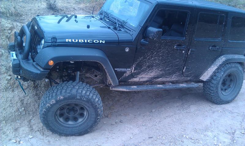

2.5" Max Travel is an amazing lift. Only issue for me is the rear tires rub from time to time. Click image for larger version

Nice photos.
