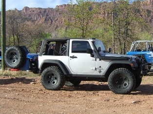

I got 3"...be very aware of your wheel offset if you are using their lower control arms. The OEM have a bend in them and RK's are straight and can rub if you are not using spacers or have a certin offset!!!

My wheel back space is 3.75 (i should be good right). thanks for the heads up.

I forget what I had...I was running AEV Wheels with MTR/K 35's and had bad rubbing issues.
Put spacers on at first but everytime I went to have any work done the shops would get their panties in a wad and did not want to touch the driveline.
CALL RK and confirm with them.
(I ended up putting a different brand lower control arm on)
