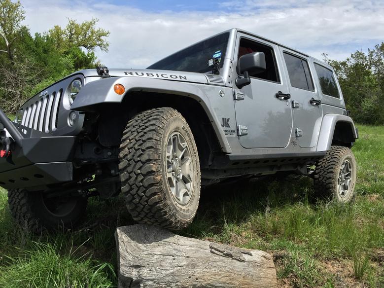

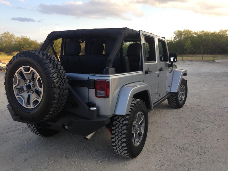

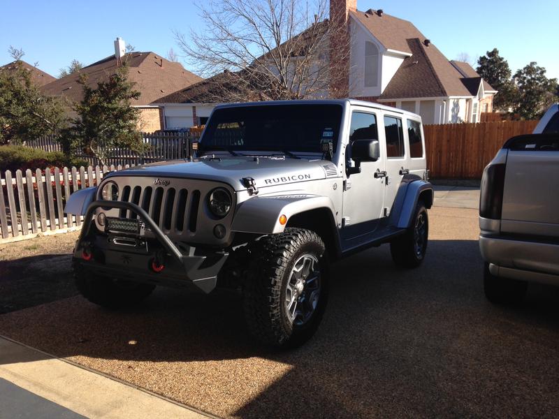

Here's how she sits now
[ATTACH]606365[/ATTACH
Attachment 606364
Attachment 606366
Looks good. You will love it even more once you do pull the trigger on a lift kit.
