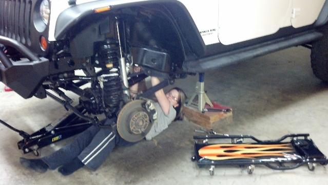

This is my wife helping me install the new control arms. I used the measurement's provided from Rock Krawler and got a 5 degree pinion angle. Have not got it aligned yet, but it drives alot better than it did with the Aev brackets. Look forward to getting the rear arms. The Aev control arm brackets are for sale if anybody is interested. $75 shipped in U.S.

You will probaly find their measurements to be pretty darn close and probaly won't have to go any further. I have a 4.5" kit and my castor is about 5.25 degrees and it drives great with no vibrations. Definately get it aligned as changing the castor angle may of thrown your toe off though it won't be much.
