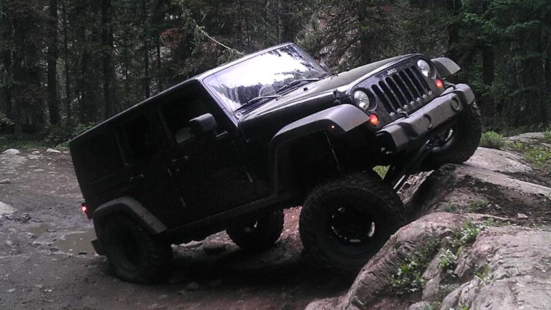

The linear spring has a constant spring rate as it compresses.
The progressive spring gradually gets stiffer as it compresses.
I have the 3.5" mid arm flex on my 4 door with the progressive rated springs. It rides like a caddy and flexes like a champ.

Ok, I checked out the website. The 3.5" mid arm kit comes with front progressive rate coils and rear linear coils.
