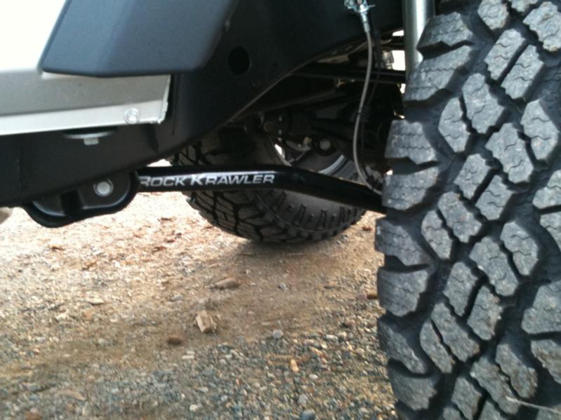

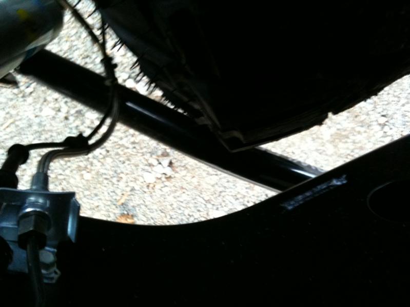

2012 JK 2dr
Duratrac 317/70/17 on Blackrock 909 4.5"BS
RK 2.5" max travel
Tires are rubbing LCA at full lock both sides
Pass side looking down
Pass side is this on backwards?

I am pretty sure there is a turn stop you can adjust somewhere. I didn't have any issues but I have less BS.
