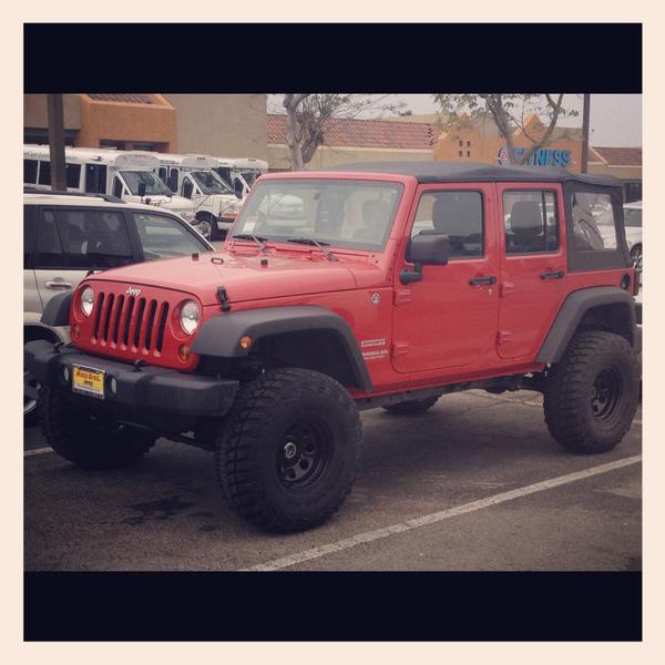

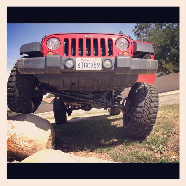

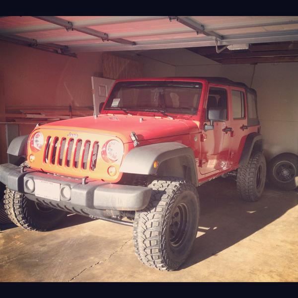

That's a great choice! Been running the 3.5" X Factor with Bilstein 5100s for about 2 months now and I absolutely love it! Rides so much nicer than stock!
I would strongly recommend adding the Ultimate High Steer Kit to finish off your lift!!

Thanks for the info. Where did you order yours front ?? Both driver & passenger side ??

If you purchase the High Steer Kit from RK, it relocates the steering stabilizer above the Tire Rod, you can actually see it in one of my pictures...
