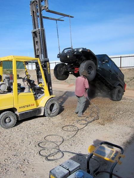

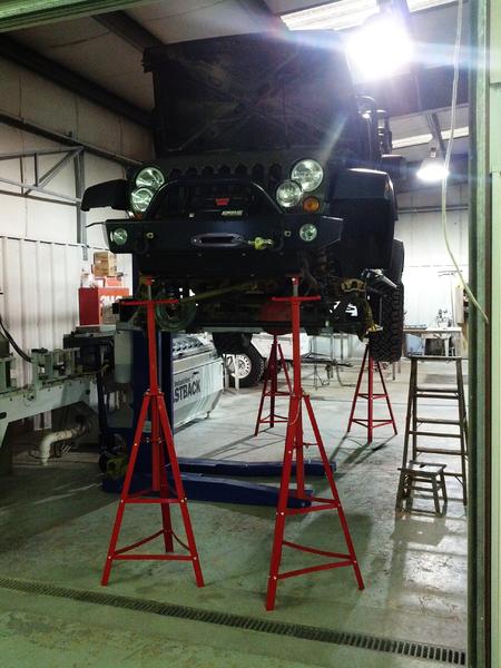

Shrockworks.
Contact them and they will make it so you can retain the OEM Rubi rails for a very clean look.
Note that my Jeep is supported by the lift at the inner tube of the rock rails. Wouldn't recommend doing this with any cheap, imported stuff ...
We did later modify the lift so that it could properly contact the frame of a Jeep JK.
Shrockworks also makes bumpers you can trust for heavy duty chores ...
The downside to Shrockworks is the time. Think weeks or even months. But worth it.
