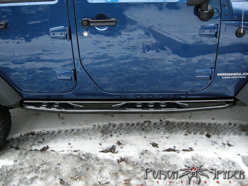

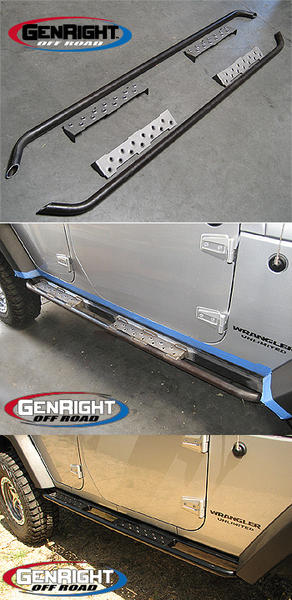

I am currently running the Rubi Rock Rails and want to add some steps to them. I am trying to decide between the following. Any suggestions?

ACE rails look really nice and clean! That is until I take them offroad I think I am starting to like this look better than my first options.

x2 on the ACE. they are awesome! those poison spyder rails look pretty nice tho...
