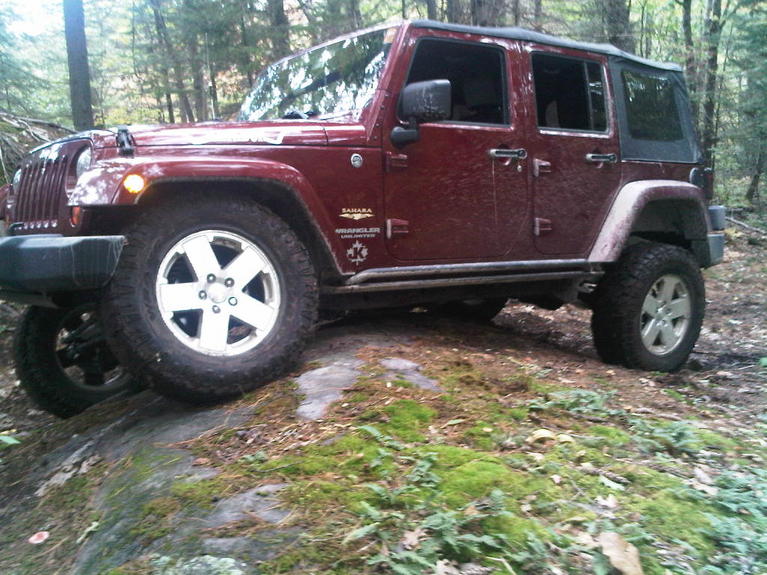

Smittybilt XRC Rock Sliders!!!!

Thanks for the pics Matador. That shows me what they would like on mine as it is a Red Rock Sahara with 33's and a 3" lift. How well do the XRC's work as a step? How was the install and have you had any issues with them bending?

They work as a step when you are raising and lowering the top....it's a small ledge but it helps. The install was kind of a PITA ...they give you small nuts and bolts that go through the pinch seam and there is not a lot of room to get them in.....you will want to use needlenose pliers and someone recommended using some tape to hold the nuts in place while you thread the bolts.
I had the SRC ones before and they flexed........make sure you get the XRC.....they are designed way better and hold up. I have come down on them pretty hard and they have held up amazing!

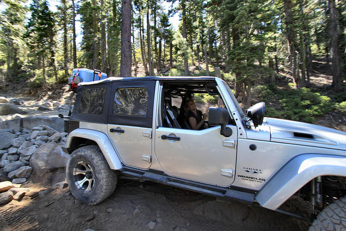

I have Hansons. Step works good for my wife. She says the step is a little small but it is a true step. I have seen then bend before. And since they are mounted to the body, if they bend the body needs work. I beat the crap out of mine, and so far so good. Just have to get them painted every year. I also put some LED lights in there. My wife was having a hard time finding the steps in the dark. I'll go find some pics and post them up

Hanson Offroad was just on the Rubicon trail with me a weekend ago. His rockers took a good beating and no issues.
