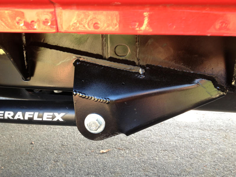

Well, I want from a short arm to a long arm. How my LOD rock slider don't fit any more. So now I have to look at options.
1. Cut the 3rd arm on the LOD rock slider and just have two arm holding up the slider on to the frame and hope that is strong enough.
2. Cut the 3rd arm on the LOD slider and relocate it somewhere in the back out of the way of the long arm.
3. Look for sliders that works on the long arm.
Looking Options and pictures.

It not rubbing. The arm now is in the way of the LOD sliders.

I have that same long arm kit installed two weeks ago. My rails don't go either. I think TF may have redesigned that rear bracket.

We cut the rear arm off and move it forward to clear the frame bracket.
You can order EVO MFG sliders for the teraflex long arm. The rear arm is not welded on to allow the installer to weld it forward of the teraflex bracket
