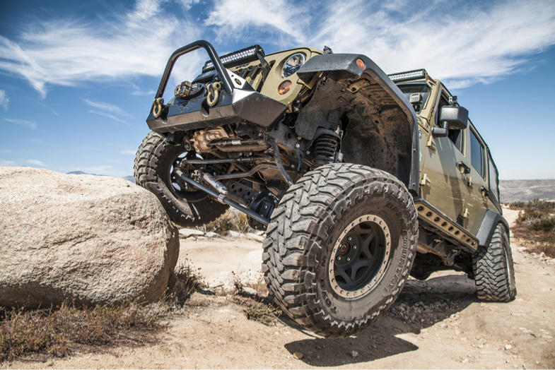

The bottom/side edge and inserts take the most abuse. Inserts I'd paint. Easy touch ups. Mine are powdercoated black with commando green painted inserts. Install is a breeze really, took me maybe 2-2.5 hours. You just need a compact drill and a few wrenches & sockets, plus hex for the inserts.
