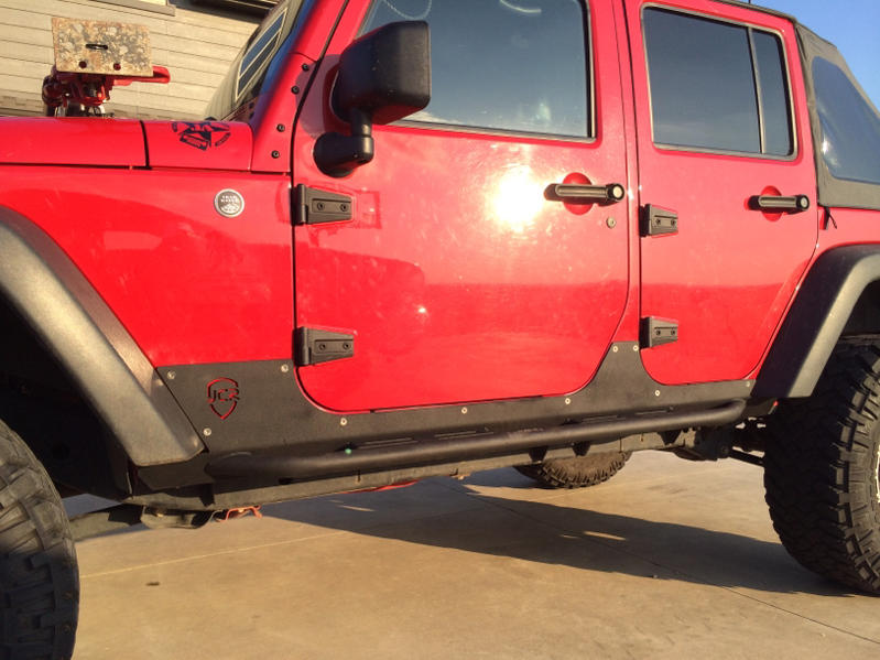

In case you haven't already made your decision, I highly recommend JCR Offroad's Crusader Rock Sliders. Frame mounted but they also have the body protection.
Attachment 581167
I have those on my 4-door. They mount to the body bolts and body not the frame. I chose them because while the frame mounted sliders are strong, they get used more often because they are mounted lower. Although infrequent, I have seen rigs get hung up on their sliders that I (stock rubi sliders at the time) was able to clear without even touching. I went with the JCR sliders because they appeared to mount up higher... If I were to do this again I think I would get the Pure Jeep variant of this slider.
