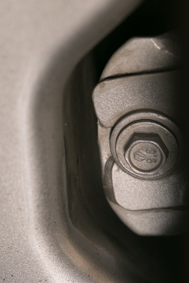

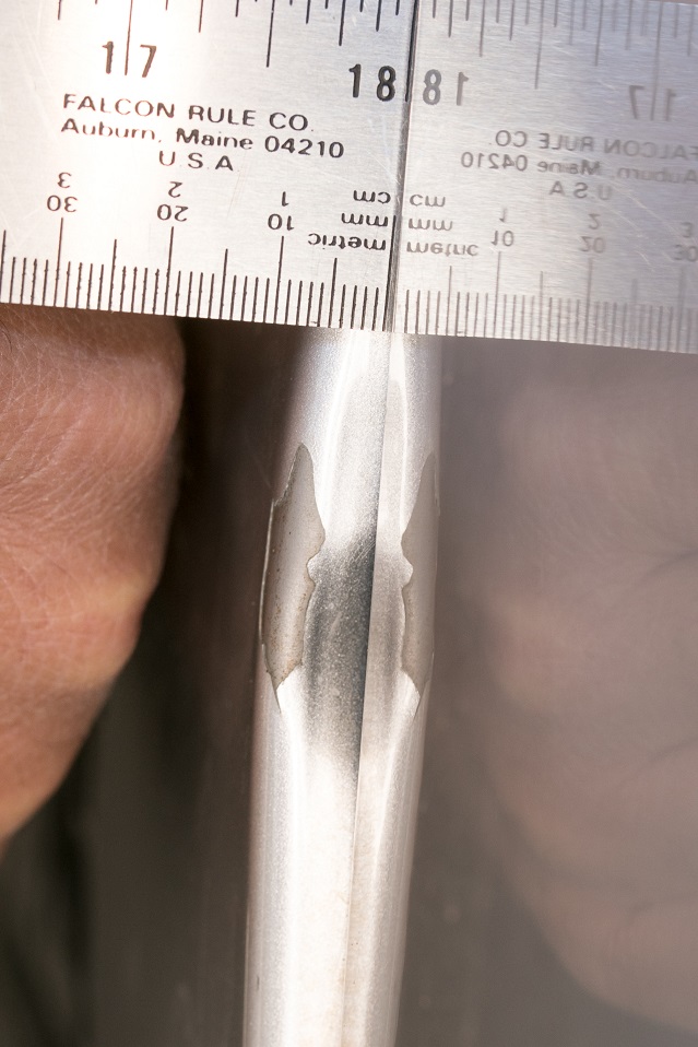

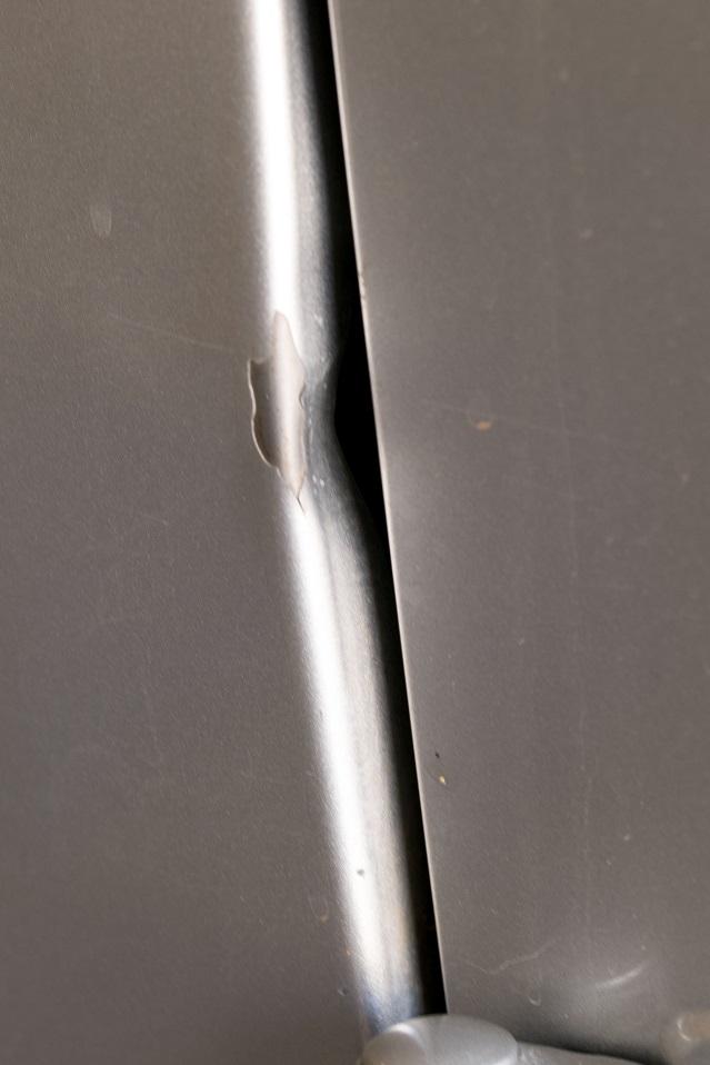

watch out for the PS sliders. Because the Slider and the side armor are bolted together if you ever do come down on a rock and the sliders flex they transfer that flex into the side armor. The side armor uses Nut-Serts in the body so it flexes the body.
These are pictures of my Rig. When I asked PS about this I was told this was "Normal" and that I was "Abusing" the sliders by banging them on rocks.

Originally Posted by PhxSilver
What about the Poison Spyder Rocker Knockers? Any good?
