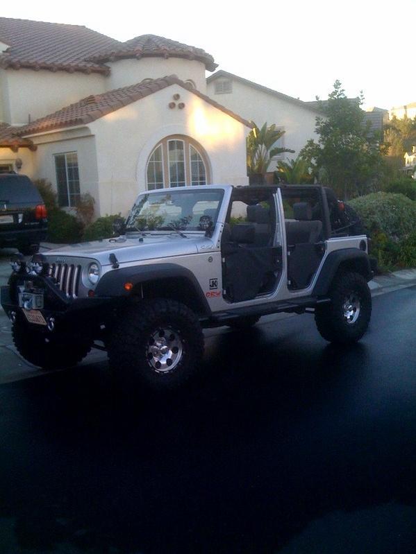

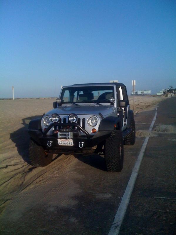

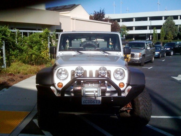

I attached a few pics shot with my camera phone-not the best quality ..No complaints whatsoever with the bumper, really like it
