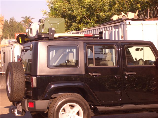

I would like to know what you think off this set up? I want to know if anyone has done this and if the roof can hold the weight?

I have been watching roof rack threads also. It seams that most of the rack systems that are approved fo heavy loads have support systems that extend all the way down to the body. I am intrested in one of the track mount systems. I think that with a few mods that they could be reliable. For instance: reinforce the bolt patern on the underside of the roof with a metal strip aproximatly 2" wide and extend the length of the bolt pattern. Bolt holes that extend throug voids shold have a metal spacer to take up th void and keep from collapsing the void. I plan on installing a track system and adding these mods as soon as funds permit. It would be nice if someone would come up with a rack system with support to the body on the underside of the hard top.

That is what i need. where can i get hold of more info on this modifiction? I would like to know how they mounted that?

I will attach some pictures of the brackets inside the hardtop.

That's a rock'n setup, assuming you don't ever want to carry anything long, like a kayak. Can you take some pics of the mounting points from inside? I'm interested to know how that rack can take so much weight without cracking the top.
We have mounted canoe's, kayaks, skiis, boards, cargo boxes and just about anything else you can think of.
The rack is able to support the large weight loads because of the inner structure that mounts right to the tub of the jeep.

The hardtop is completely removable but the roof rack will have to come off with it. The rack makes it very easy to hold to remove the hard top because you have something to hang onto...
