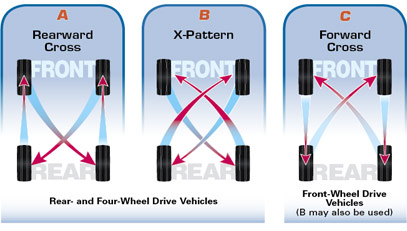

This is from Tire Rack. Why no spare?

well...... I cant see why it would make a huge difference between A or B. I dont think the Jeep will drive off into a ditch if use one or the other. I am liking A!

And further down this page....
Tire Tech Information - Tire Rotation Instructions
Is the 5 tire rotation.
Just be sure your tire can rotate both ways! (Non-directional)
"G" pattern (rearward cross) is best for 4WD Jeep (ed.: with spare).

Thanks- they are not directional...after further consideration I am going with B and will do A next time
