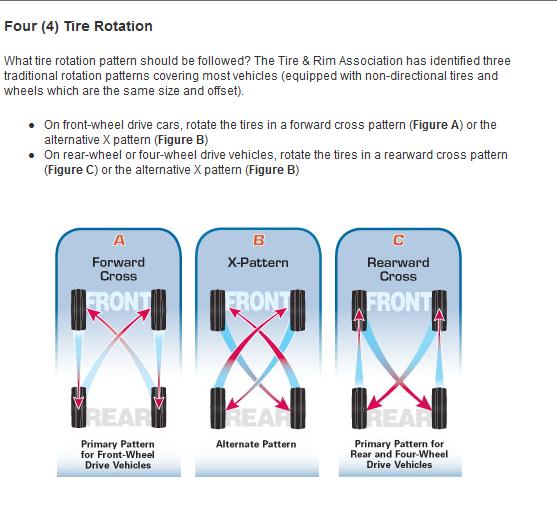

I personally do the 4 tire rotation with the X pattern as shown below.
