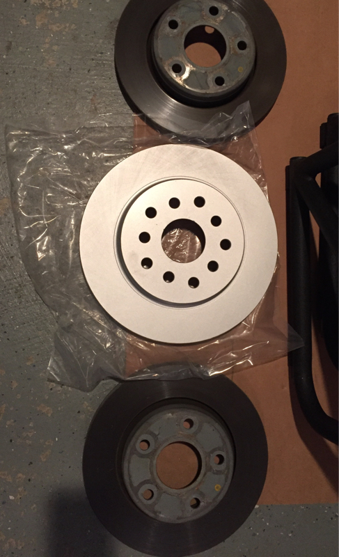

Old Jun 11, 2016 | 08:22 AM
afpilot82's Avatar
Posts: 2,150
From: Cheyenne, WY
Originally Posted by alecwaller1
Are there any modifications that I need to make to install them?
Nope, they bolt right on. Check TF YouTube channel for an easy to follow install video. I installed the fronts a couple weeks ago. they are beefy.
