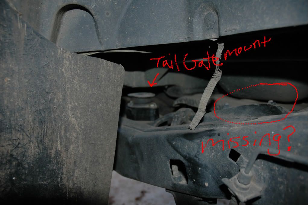

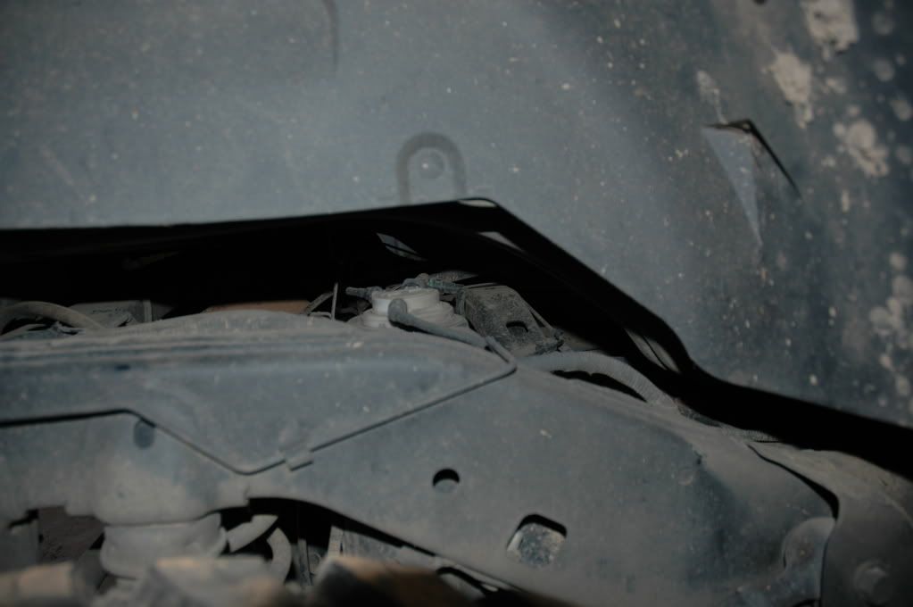

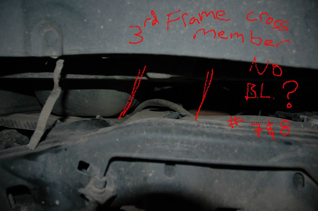

So I got a sweet deal on a RC 1.25" BL, got all the parts, read the instructions and proceeded on my way to liftage. Unfortunately I ran into a problem. The instructions state a 2dr JK should have 5 body mounts per side...I swear I only have 4. I am missing #7&8 which would be directly above/below the 3rd frame cross-member back from the front...between the tailgate mount and the mount just to the rear of the door. Here are some pictures from the gap where there should be a mount. I called RC and told them my problem...they chuckled and said, "well if there's only four, there's only four"...which is not a solution...
Anyone else have this issue? Should I be extremely concerned my body tub mounts to my frame with only 8 centering pin mounts?

You have 4 per side on a 2 door (2008-2010)...8 total. The 2007's had 5 per side from what I heard.
I have a body lift on my 08' 2 door so I'm talking from experience.
