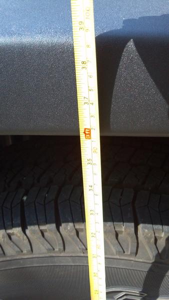

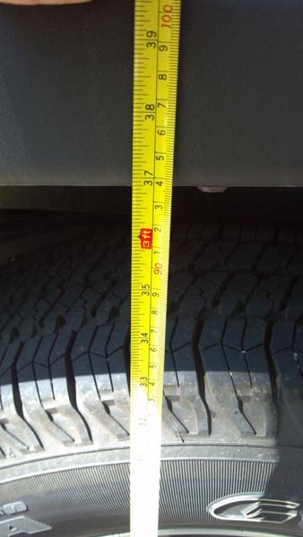

Just installed the RC 2.5" coil lift (new springs) yesterday. I literally gained 4" in the front and 3" in the rear. Here's the measurements to the top of my flares. And they are both dead nuts at 40" now. May sag at some point but right now I couldn't be happier with it. Absolutely no rake!

EDIT: Just realized that those measurements were also with 2 different sized tires. Went from stock 17's to 35" x 16's.
