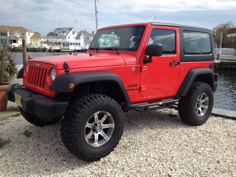

Nice kit, everything fit perfectly into place without any problems. Did it in an afternoon in the driveway. Rides smooth, didn't lose any drivability. Haven't aligned it yet, but I can let go of the wheel and it tracks straight. I will have it done by the weekend. Doesn't seem there is much to adjust at this point though.
