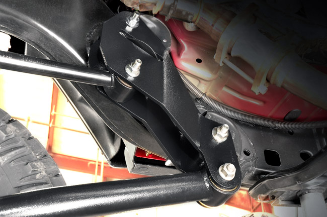

I'm curious too. Rancho's brackets are good, but according to AEV, their geometry is superior. The photos on Rough Country's website seem to show that their brackets relocate the arms similar (if not identical) to AEV's:
Does anyone have any experience with or knowledge of the Rough Country control arm brackets?

Yes, the relocation brackets correct castor like adjustable control arms do. But the brackets are a lot cheaper, allow the superior OEM bushings to be retained, fight brake dive, and allow the springs to absorb more of the road shocks that increased-angle control arms transfer direct to the chassis. The tradeoff for better ride and handling is a slight reduction in ground clearance in the control arm mounting location.

Complete bolt on; just like the AEV ones. Neither set requires cutting of the factory brackets.
Attachment 258386
I emailed Rough Country inquiring about their brackets' geometry, but I haven't gotten a reply back yet.
Since these brackets are prone to hittin rocks, I'm curious if any of the 3 manufacturers (AEV, Rough Country, or Rancho) use a thicker gauge steel than the others for additional durability and resistance to bending or tweaking?
