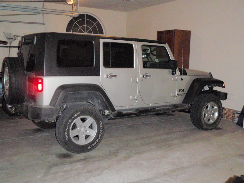

I have the x series 4" lift. Overall I am pleased with it. I did add the rough country single steering stabilizer and a dropped pitman arm.
Old Oct 12, 2010 | 06:49 PM
REDLINE217's Avatar
Posts: 132
From: San Antonio, Texas
Looks good did you install it yourself ?

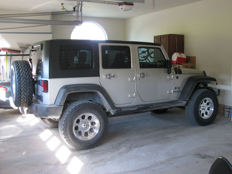

I have recently installed the RC 3.5 lift with 35's and I love it. I comes with a newer version of their shock that seems pretty smooth. I had the alignment set back to factory spec after the lift with no trouble. I did the install in my garage in about 7 hours but I really took my time to double check everything. I think it is a pretty good deal.
