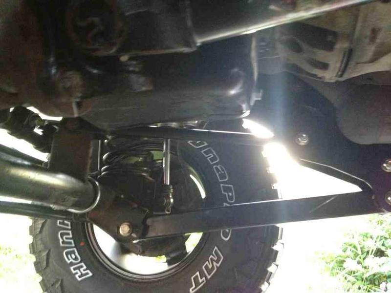

-Psi #1
-Those bilsteins are known to be on the harsher side.
I just installed AEV's front control arm brackets and they make a huge difference in how shock is transmitted up into the jeep. Flatter CA's and impact is directed through the shock rather then the frame.
